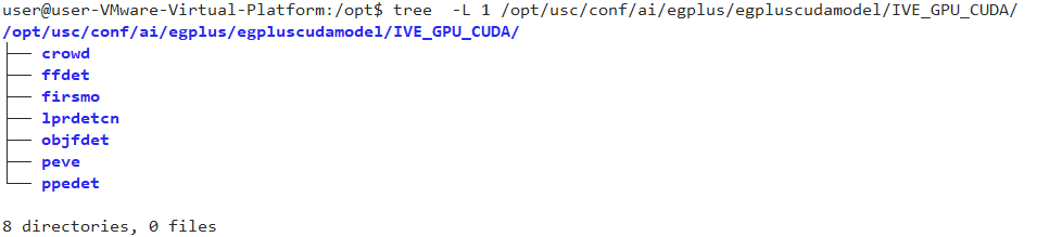

 Contact technical support to obtain the model file package egplus.zip, and place the files in egplus/egpluscudamodel into the modules/ai/egplus/egpluscudamodel directory. The final directory structure is as follows:
00-SettingLinuxGPUEgplus

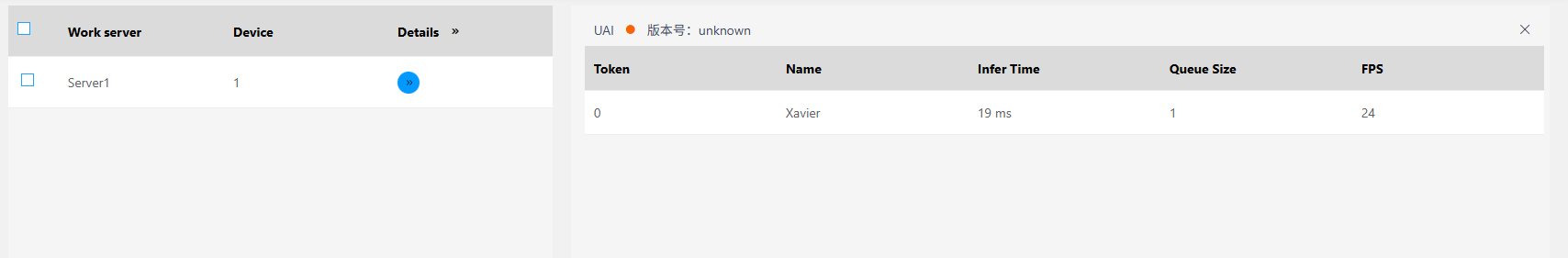

The system will generate optimized models based on the GPU model when it is first started. After about 5 minutes, there will be a prompt in the Analyze-》Settings-》Inference Service Status. Refer to the following figure:
00-SettingNGPUInit

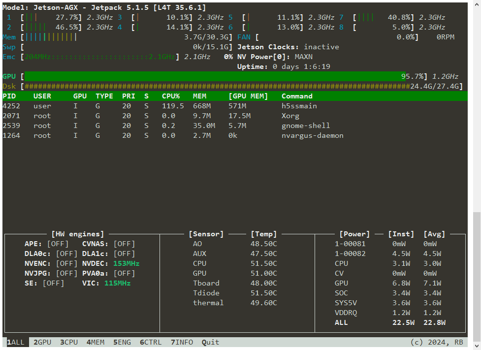

jtop Status
Once the model is running, you can use jtop to check the GPU decoding and inference performance.
00-JetsonCUDAInfer
