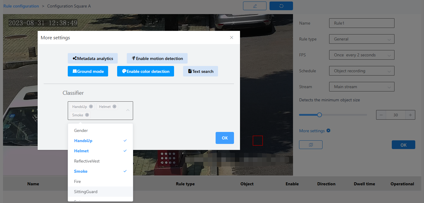

Rule configuration:
1. Select the device under the root node, and click on the configuration under the edit field on the right side of the interface
2. Custom name
3. Select the check type as Basic Configuration
4. Customize the frame rate or use the default frame rate
5. Select a plan
6. Open metadata analysis
7. Select the code stream
8. Adjust the minimum object size for detection
9. Configure more settings
10. Click the Brush button to draw a frame in the image.After drawing the frame, you need to click the brush button to confirm that the frame is drawn
11. Next to the Brush button is the Restore button, which restores the frameless state
12. Finally click the OK button
